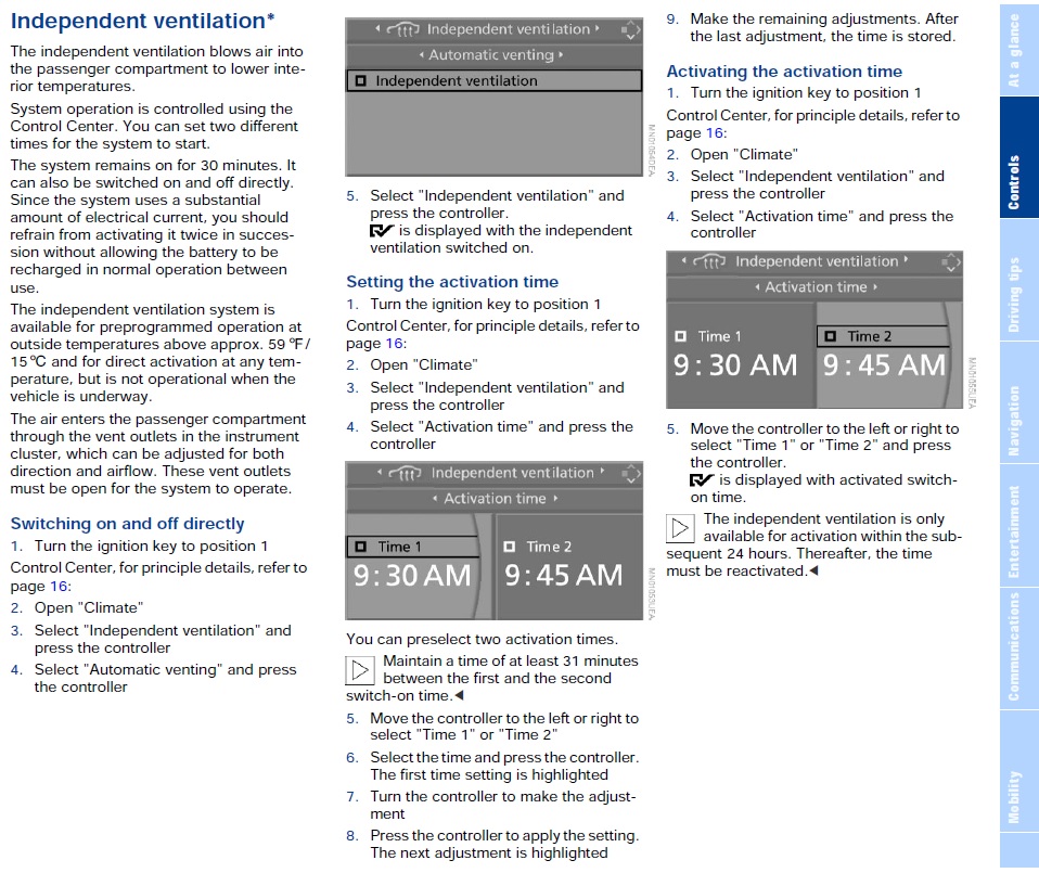

manual ütleb nii:
Independent ventilation*
The independent ventilation blows air into
the passenger compartment to lower interior
temperatures.
System operation is controlled using the
Control Center. You can set two different
times for the system to start.
The system remains on for 30 minutes. It
can also be switched on and off directly.
Since the system uses a substantial
amount of electrical current, you should
refrain from activating it twice in succession
without allowing the battery to be
recharged in normal operation between
use.
The independent ventilation system is
available for preprogrammed operation at
outside temperatures above approx. 59F/15C and for direct activation at any temperature,
but is not operational when the
vehicle is underway.
The air enters the passenger compartment
through the vent outlets in the instrument
cluster, which can be adjusted for both
direction and airflow. These vent outlets
must be open for the system to operate.

Aitäh Kert selle juhendi eest kuid väga palju sellest juhendist ma ei leia....nimelt huvitab,et kuidas saaks seda 2 timeri süsteemi kasutada eelsoendusena...eriti veel praeguste krõbedate ilmadega tunnen sellisest luksusest puudust...võiks ikka kuidagi saada selle süsteemi sooja puhuma...hetkel ainult külma puhub kui timerid paika seadistada
