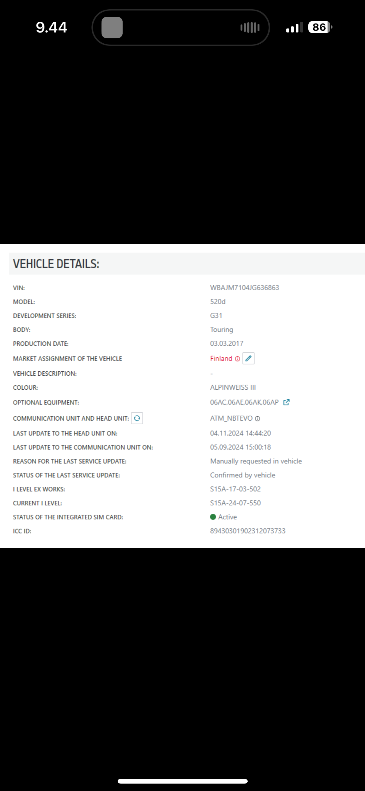

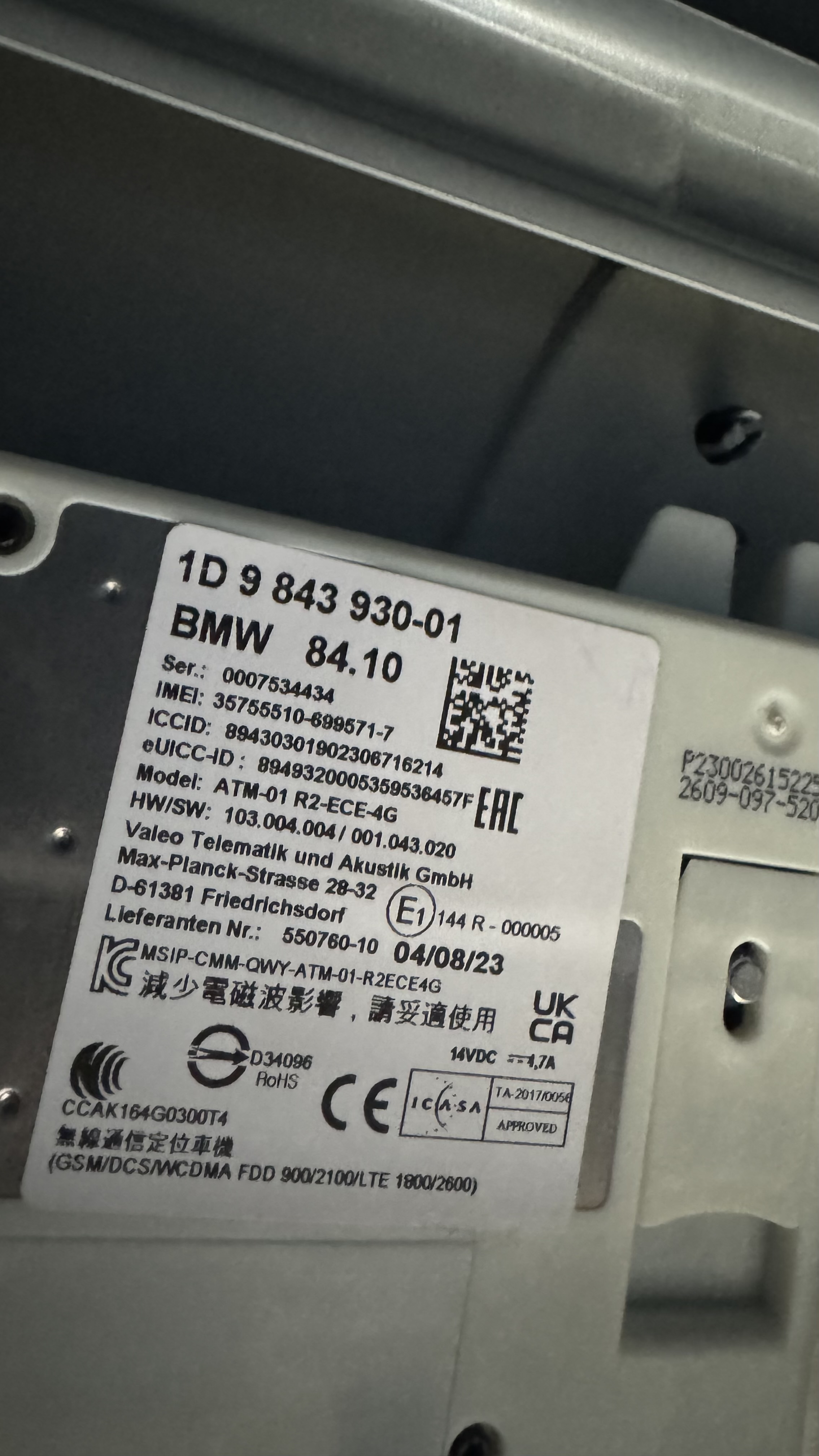

Re: Connected Drive
SITUATION
BMW Online/BMW ConnectedDrive not functional.
CAUSE
Vehicle and service cockpit have different ICC-ID’s (Integrated Circuit Card Identifier).
Tcb on paigaldatud ikka soome bmw esinduses.
Tänud meili aadressi eest saadan neile ka.
CAUSE
BMW g31 520d M Sport

Re: Connected Drive
Pilt dealer cockpitist 22.11.
Auto tcb.
Nagu näga icc id ei klapi.
